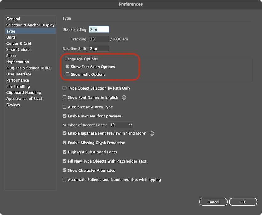

Monika Gause
October 9, 2024
Do you have an Arabic version installed?
Gareth_Williams
October 9, 2024
An Arabic version of what? Do you need an Arabic version of Illustartor with different panels?
Monika Gause
October 9, 2024
The Arabic version has the full support.
You can try if you can get around when you turn on "Show Indic options" in Preferences > Type. If it doesn't work, you need the Arabic version.
