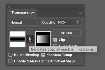

Is the Link icon checked between the art and the mask?

The issue is the same whether the two are linked or not. I meant to mention in my post that the issue might lie in the fact that the axis of rotation is different for the mask than it is for the object. I imagine that, when I had first constructed the rectangle to create the mask, if the object had been perfectly centered in said rectangle, I wouldn't be having this problem. But that would have taken a lot of time and effort and seems like it shouldn't be necessary.
