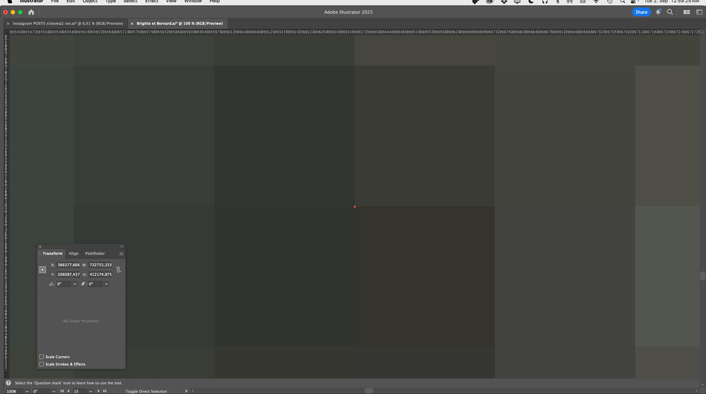

I am having so many problems with new Illustration, is not showing properly a file with multiples artworks. It shows me messages that I do not know what the mean.. This new Illustrator so far is a bummer.
I am not sure if the file is corrupted or not.. cause it shows everything so wrong. It moves the grafics away from the artworks is a total mess. It gives super strange percentage in "view", look the mess in the rulers. Also I have problems with saving files. Please can anybody give me tipos & and help?Screenshot 2025-09-01 at 9.48.13 PM.png

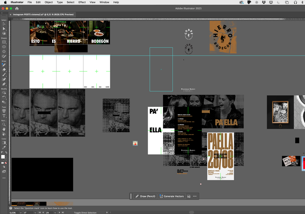

This certainly is strange! I do see you're zoomed out to .03% which is insane zoom! Can you click the place in the lower left of your screen, where it says .03% and change your view from there? It looks like you clicked Option+Command 0, or hit View>Fit All In Window. Changing your zoom in the View menu, or using that widget at the bottom should move you to normal view.
This looks like it might have been a page on which you'd maybe placed a bunch of elements and either didn't resize them down, or somehow got rid of the resizing. Another way they could have gone in at that size, is if you used drag and drop, instead of File>Place to get them on an artboard.
On this screen I can only make out 3 artboards that are not aligned with each other. Is this the same amount of artboards that show in your Window>Artboards panel, or are others hidden from view?
If this was what my screen looked like, I'd do my best to move and approximately resize whatever I needed to fit on any of my existing artboards (I'd even stack a bunch of things into ONE artboard, and then distribute them to new artboards that have the settings I want). Then, I'd likely use the Artboards tool with Shift to select multiples of the existing artboards, and then use the alignment options in my control bar (or Window>Align) to arrange the artboards and separate them out as needed - also resizing them to the dimensions I want. If I THEN needed more artboards, I'd make them and move my assets into them.
With so many things on here, it may also help to rename the appropriate layers and sublayers, so you know what's on each. Layer management is SO helpful here, especially when organizing things. I'm a big fan of the selection column, for moving things among layers. If you want to learn more about those, check out https://helpx.adobe.com/illustrator/using/layers.html
It would take some work, but then you can see everything on there, and not have to be sooooo very zoomed out - and you wouldn't have to start from scratch, and reimport everything. Of course, that's also an option, if you prefer. .

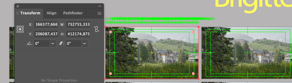

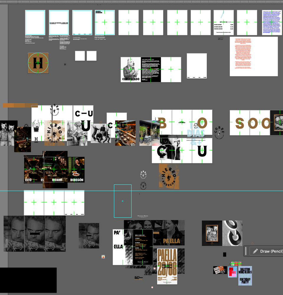

Thank you for taking the time to look up. Many crazy things happend, it changed the sizes of everything. believe me when I say I am not new in Illlustrator.. most of my sizes we instagram tipical sizes, 1080 px x 1350 or 1080 x 1920, and since I am designing the system I was doing them all together to keep consistency. Is something that I allways do... /BUT I've just remembered it did THE SAME crazy problems with sizes / rulers and views,  with a storyboard I have for an After Effect project, the size were 1920 x 1080, and it CHANGED all the artwork sizes , on the other adobe illustrator too (the one that has instagram sizes) and it gives this crazy ruler sizes , I try to put "Artwork rules" nothing changes. And in the case of  file with many instagram post it also moved the graphics away of each artwork, so is a complete mess. Screenshot 2025-09-02 at 12.52.41 AM.pngScreenshot 2025-09-02 at 12.57.18 AM.pngScreenshot 2025-09-02 at 12.59.02 AM.pngScreenshot 2025-09-02 at 12.59.25 AM.png

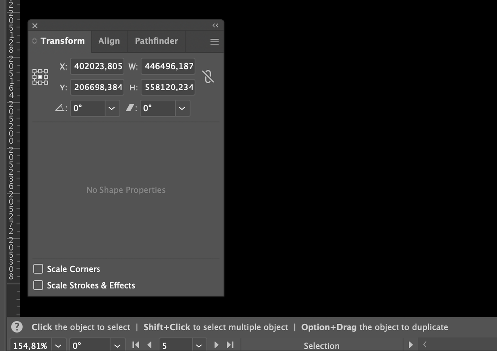

Also this message at the very bottom, I never had it, want to put it off, don't know how. But I guess is a problem with the RULE, the units, that conects with the "views" of course , but is practically unusable the illustrator for me. Tried to downlaod the Beta but it says "damage" thried 2 times, so now I am going back to the previus crossing my fingers I do not loose all the work.  Screenshot 2025-09-02 at 1.10.25 AM.png

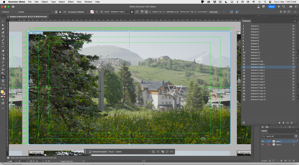

Ok I've just downloaded the beta.. and I have the same problem RULES / ZOMM measures are working terribly. This is a storyboard, when I created the artwork they were 1920 x 1080 points, now it has this crazy sizes, I did not change it, and then you get all this crazy things in the rules...Screenshot 2025-09-02 at 1.29.12 AM.png

The message you see at the bottom is the Help bar, you can turn it off in the View menu.
