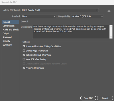

here is the current PDF screen
The layers stay the exact same, except all the layers of the original get flattened onto the first layer, while the other layers remain the same.

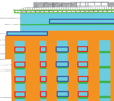

I have found another issue which might make it more clear, i use the initial architet drawing for two different jobs,and saved it as seperate files for each.
I have one with blue lines drawn as such
and one with coloured sections as such
i believe the issue may be to do with linked files as when opening my file with the blue lines today it has flattened the image with colours and use that as the "original" layer. shown below where it seems to combine the files.
For some reason the linked file takes the copy i made and not the original document.
