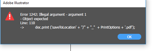

when i try to run the script in debug mode, it just pops up a script alert with ok button for every layer that is in the file
and gives me an error on the line:
  doc.saveAs(saveToLocation + '/' + 'XS.pdf', saveOpts); and gives me an error 1242 illegal argument, file/folder excpected.

Contributor ,
Nov 12, 2018 Nov 12, 2018
im trying to get the layers to print, but i get this error and the debug stops on the last line
var saveToLocation = doc.Path;
// Saves active file as.....
        var jbOpts            = new PrintJobOptions();
        var opts              = new PrintOptions();
        opts.printPreset      = "PP Print";
        opts.jobOptions       = jbOpts;
        doc.print ('saveToLocation' + "/" + "_"  +  "S-M.pdf" , 'opts', 'jbOpts' );   // debug stops on this line
would it also be possible to turn on the option to print multiple pdf-s, not just one? ) select all sizes, or just 2/3 for example.
Engaged ,
Your doc.print statement I believe is formatted incorrectly.
jbOpts.file           = new File(saveToLocation);
doc.print(opts);
See if that corrects your first issue....
After that we can work on getting the ability to do multiple selections.
Contributor ,
now i get a success alert, but instead of a pdf, it creates a tmp file in the folder. when i try to manually print with the selected print preset, it works.

Contributor ,
Nov 13, 2018 Nov 13, 2018
im not sure if this is the right way, but that's how my pc has been set up(not by me).
Right now the process goes: Print > use Print preset "x" > save pdf to selected folder. Print preset uses Adobe PDF as printer ( which in the printer properties has a custom preset), PPD is default Adobe PDF. i think you also cant choose color management in the adobe pdf preset, which is why i think i have to do it this way?
Engaged ,
If possible, in my opinion, would be a better option if you could save multiple PDF files as opposed to printing to a PDF printer.
If you find out what the settings are maybe we could replicate them using the saveAs method.
If you have to go through that method of printing to PDF printer...
This should help...
    var printOpts = new PrintOptions();
    printOpts.printerName = "Adobe PDF";
    // Change the name to your PPD
    printOpts.PPDName = "Default (Adobe PDF)";
    doc.print(printOpts);
Contributor ,
i managed to get the pdf printer working by doing this:
var printJobOptions= new PrintJobOptions();
       var options = new PrintOptions();
       options.jobOptions = printJobOptions;
        printJobOptions.copies=1;
        var PP="PDF print";
        options.printPreset=PP;
        doc.print(options);
i copied this part from another script i have.
now the new problem is, that it does not automatically name the file  and save it to docpath. it opens the save as window and asks for a name and folder.
