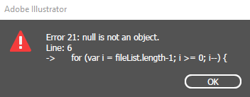

Jan 08, 2021 Jan 08, 2021
Getting this error message...
There is a typo in the loop.
for (var i = fileList.length; i <= fileList.length; i--) {
Should be:
for (var i = fileList.length-1; i >= 0; i--) {
