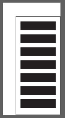

Can I rotate the content of an artboard with  180 degrees with a script?and optional : to save in ai format but for an older version than  CS6
I know it's possible with an action, but it's about several files with different formats..
Thank you

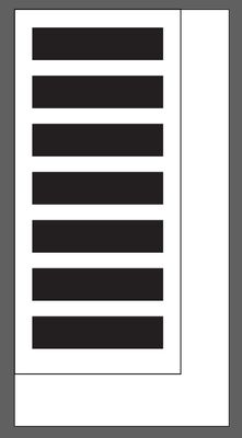

Urraco37Author
March 24, 2021
Sorry but is not work
the rotation  must be as in the picture I attached above..as if you were rotating the artboard and content
Thank you
