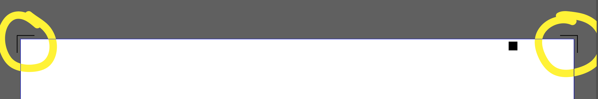

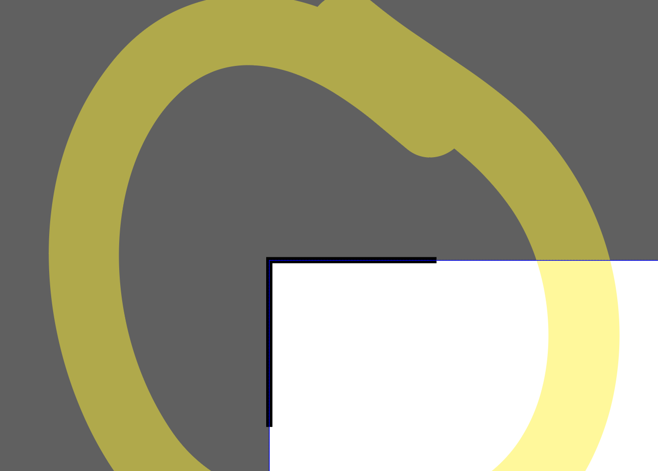

Hi i have a Layer "Corner Marks" that i would like to automatically fit to the outside bounds of the artboard (the 4 corners.). the Marks are auto inserted but seem to be offset from the artboard a little bit. Thanks everyone.
From (All 4 Corners)

I would like to go to (All 4 COrners)
