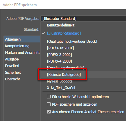

Oct 24, 2018 Oct 24, 2018
What is your mothers language?
opts.pDFPreset = "[Smallest File Size]";
Do you have a PDF preset with the exact name [Smallest File Size] ?
Engaged ,
It's built into the Save Adobe PDF menu for presets out of Illustrator isn't it?
Not you subieguy2​
(I meant the mother language of the TO)
Engaged ,
Here is the German version for example
