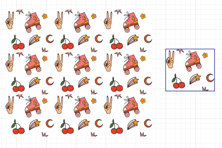

I have tried to create seamless patterns over the last few days and getting varied success.
I firstly followed YouTube tutorials which create an artboard (say 150px2) .. add the artwork, duplicate in front and add 150px to the Y axis and again to the X axis. Fill the middle freely. Group and expand the artwork. Toggle vision off on the artwork layer and create a new layer to form a bounding box. Toggle view back on artwork layer. Use Pathfinder and crop. Drag pattern to the library and it should be complete.
This does not work for me. I watched a few different tutorials and they all followed the same steps so I am wondering if there is an error in the above process.
Secondly, I opted for illustrators pattern tool. Patterns appear to be ok when making, save as PNG or JPEG. When then opening the PNG or JPEG files the patterns are not saved in the library and when added and used do not align correctly.
Images below for reference.
Halloween Pattern is the result of the YouTube tutorials and the Skate pattern is a result of illustrators pattern tool.

I followed the video above to a tee. Every single step. Pattern looks great on the tile and when I create a bigger rectangle in the same artboard it looks perfect. No seams/joins or distortions. I export the PNG.
Open a new artboard and copy the PNG file to it. Drag it to the swatches panel and create a rectangle the size of my artboard. Fill the rectangle with the pattern and this happens (photo attached). It's not seamless at all and I don't know what I am doing wrong.
The objective is to sell these patterns - I can't sell the patterns not knowing if the customer is going to experience issues like I am 😞

So once I have made the pattern tile, I  drag it to the swatches with the bounding box around it (no fill or border).
Then I would zoom right out so I can create a large rectangle and fill it with the pattern. In this instance, the pattern usually appears fine but for some reason the attached (ghost) is now happening 😞
If the large rectangle all looks ok, I remove the artwork from the pattern tile, fill with the pattern from the swatch and export as PNG. Opening a new document, I have to copy the pattern from another artboard to allow for it to be added to the swatches. If I place the pattern PNG it will not add to swatches. I make a rectangle to fit the artboard and fill with the pattern and this happens (skate pattern). Not seamless.
It has to be me making a stupid error but I can't for the life of me see where or how!

No the rectangle is just to check the pattern has worked on a larger space. I always export the PNG as a square. For instance, my artboards are 3inch x 3inch setup for print.
Oct 28, 2022 Oct 28, 2022
I am not sure what you are doing, but your examples show a wrong boundery of your pattern tiles.
Double click the pattern in the Swatches panel and correct the tile.

Can you post a screenshot of your art selected, prior to making that a pattern, We see your problem, but we cannot tell what you are using for artwork to create the issue so is hard to help you without knowing.
Advocate ,
Nov 30, 2022 Nov 30, 2022
Xmrlx, as others have mentioned, it would be helpful if you would share your actual Illustrator file.
From what I can determine, it’s not going to tile correctly as it stands.
It’s just a matter of rearranging your art elements.
Look at your star in particular.
