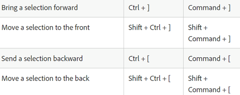

Hi there,
Sorry to hear about the trouble you are facing. As Bill mentioned above, following shortcuts only work if the objects are in the same layer.
Let us know if you if have any additional questions, we'll be happy to help.
