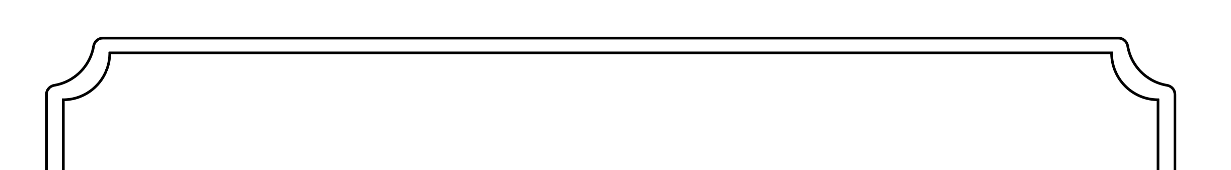

Hi, I'm new in Ilustrator and learning.
I have this set of corners that I'm trying to shape a bit more with the direct selection tool, but I was wondering if they could be shaped in the same way at the same time so they end up looking the same.
Thanks!
The  screenshot doesn't let me show the arrow, but basically I want to make the outer corners a bit more curved and I'm using the direct selection tool where when I hover over the line with the mouse a little curved line with two squares on ecah end appears.

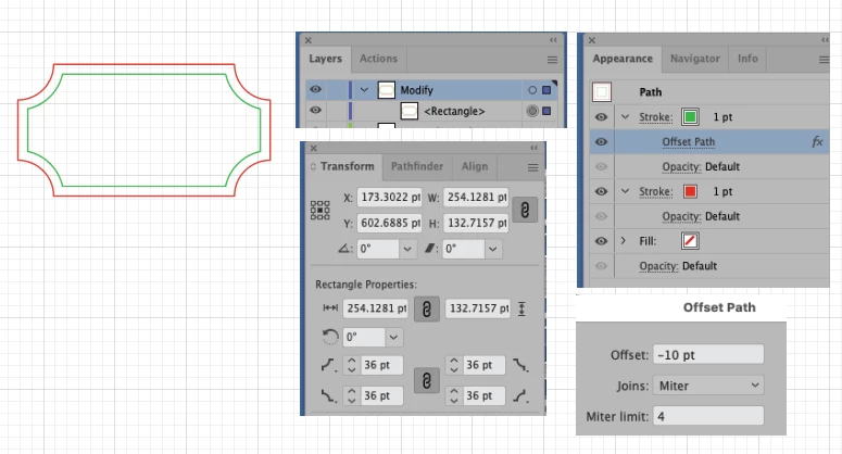

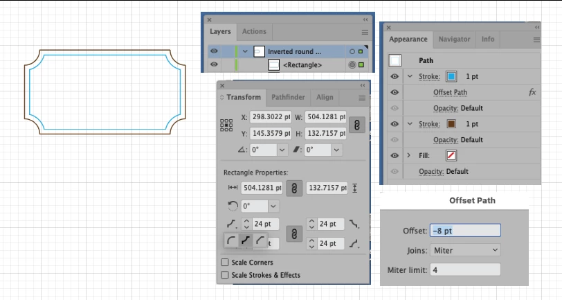

Yeshayac, If I understand you correctly, you are wanting inverted corners with an inset stroke and easy edits to modify.
Here are the steps I used. It’s just one rectangle.
With your rectangle tool, draw a rectangle. (shown in brown)
In your Transform panel, select inverted corners. Type in the radius you want. I choose 24.
While still selected, Appearance Panel, Add a new Stroke, located in the flyout menu, shown in cyan here)
Give that cyan stroke an offset effect. (Effect>Path>Offset. Here I used -8)
OK, say you want to modify. No problem. Everything is still live.
See the screen shot below with the new settings.

yeshayacAuthor
January 19, 2024
Thanks! I used that and then just made the outer corner rounder with the pen

January 14, 2024
As Bobby Handerson mention you can use Corner widget. See capture
