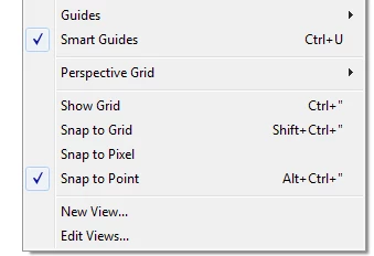

snapping not working on text objects
my guides are turned on and work fine with shapes but when I try to space text objects the same distance apart the guides do not appear.

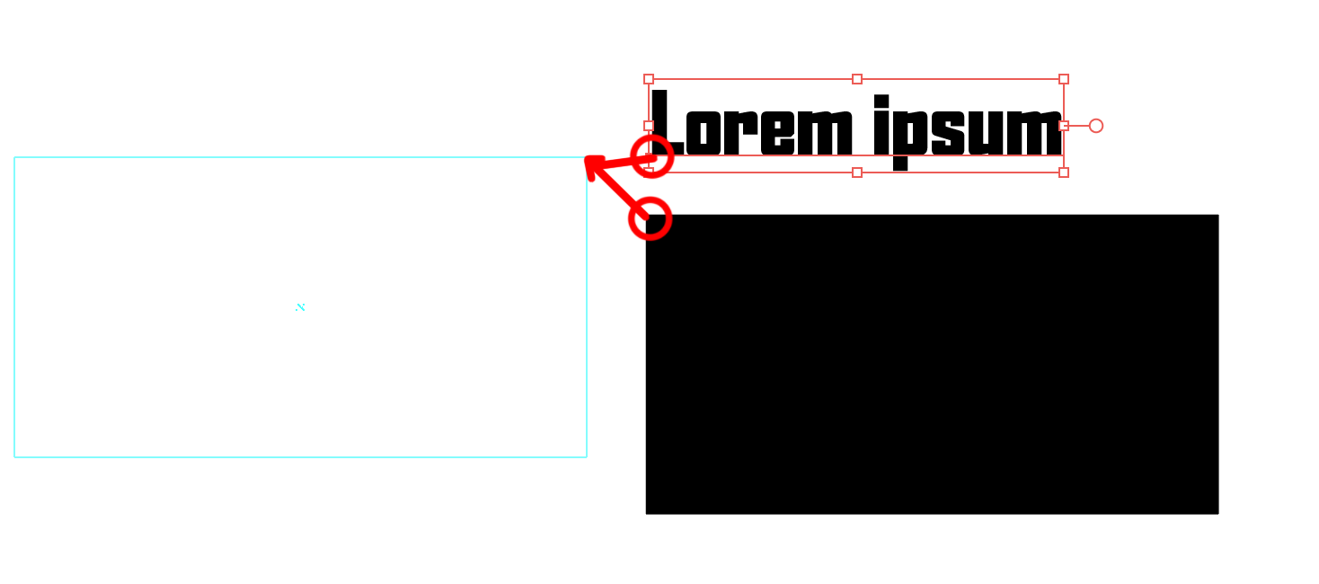

i find the spacing guides appear with area type but not point type objects. which are you using?
i just checked in CC2017 and the behaviour seems the same.
just to make sure we're talking about the same thing -- these guides:
