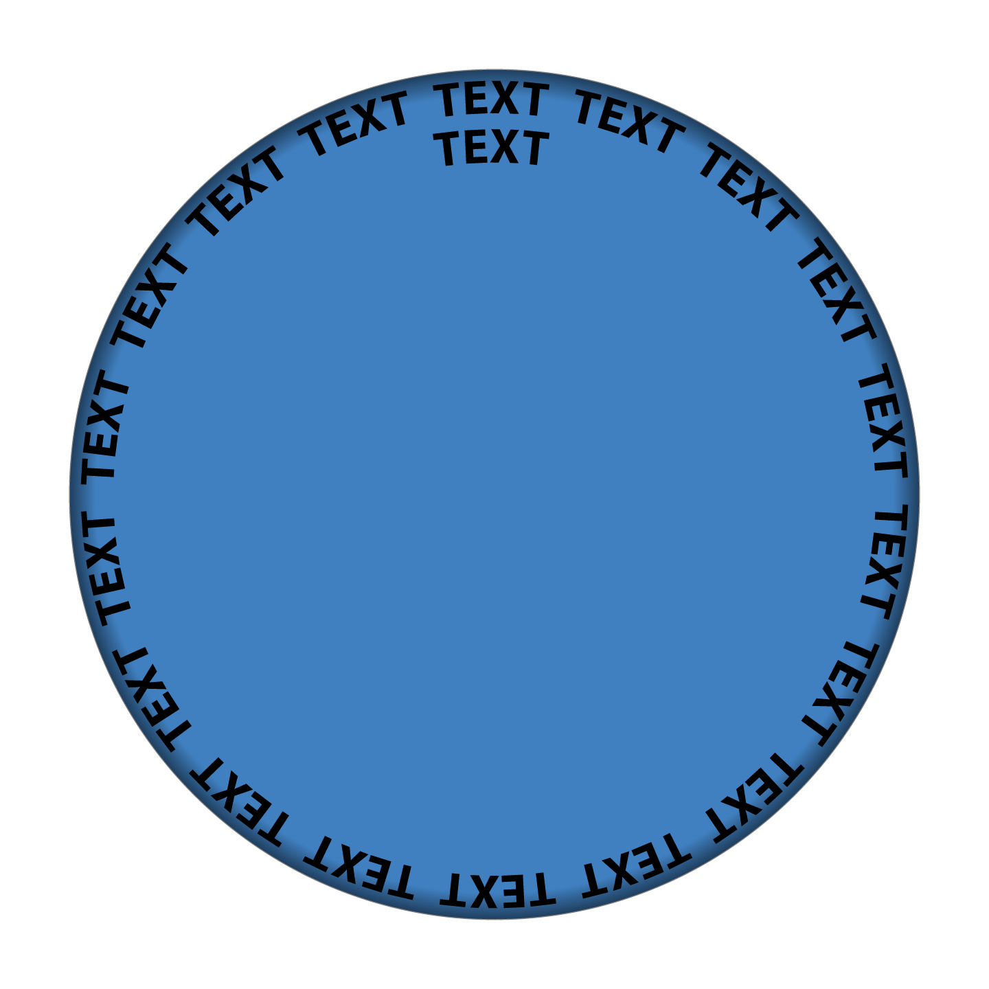

Fvta,
From the wording accompanying the Gayla cap:
"To me, the very top-height of the uppercase letters appear to be stretched outward ever so slightly, and that is the effect I hope to accomplish. Subtle."
To me the there appears to be no stretching.
From your original description:
"I want the top edge of all text to bend down just a little, as if beginning to wrap downward to the side of the circular shape"
Rather than a stretching, I believe a (possibly exaggerated) shortening (only) at the top of the letters is the best way to enhance the impression of their bendig down in addition to the (possibly exaggerated) shading at the rim, which in itself (only) gives a certain impression of bending down (or up).
And a shortening at the top of the letters is exactly what is obtained by the 3D approach shown by Conrad: most conspicuously you can see how the top bars of letters are thinner.
In a simple case like the repetition of TEXT round the cap you could just change one instance and then use an Effect to reppeat it and then add the shading, as shown in this crude sample where you can make a direct comparisom with the original TEXT without the shortened top:
Click/RightClick to get closer, Click again to get closer still
But for the reproduction of the real cap, the 3D is the obvious way to shorten the top of the letters.
I believe that you will wish to have the appearance of seeing the cap straight on with lighting from the top (centre) at a suitable distance, in other words the same shading all the way round.
I also believe that you will prefer an enhanced impression of the bending down at the rim, of the cap including text, in order to make it noticeable.
You can work with the 3D settings to get the right (possibly enhanced) shortening and see whether you can also get the right (possibly enhanced) shading.
Or you can create an independent enhanced shading as in the crude sample above (made with a circular blend/gradient with varying transparency on top of the solid cap colour), to enhance the contribution from the shading to the impression of the bending down at the rim independently of the contribution from the text shortening, possibly corresponding to a lighting from a suitably low distance above the cap.
As with the 3D text shortening, you can work with the settings of the blend/gradient to fine tune (including the sizes of the circles they are based upon witch may be different to the sizes used for the 3D text shortening); that is easier/more convenient with a blend, I believe.
