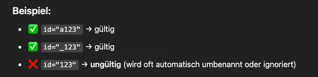

Hello, shure, Look my Printscreen

Hello @David27818564tdez,
Thanks for sharing the details. The SVG standard does not allow IDs to start with numbers. Learn more here: (https://adobe.ly/3YkHeHC).
Feel free to reach out if you have more questions or need assistance. We'd be happy to help.
