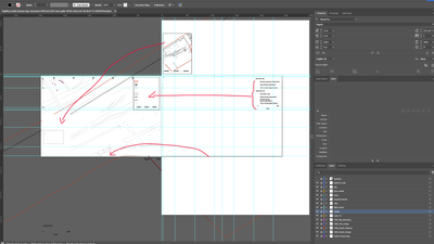

Explorer ,
Sep 29, 2025 Sep 29, 2025
I hope you received the file I sent you by email. For me it's random too, other projects are still fine.
What I also noticed is that the centerpoints of some elements are way off the canvas when I select everything. see image. Not sure if it has something to do with this..
