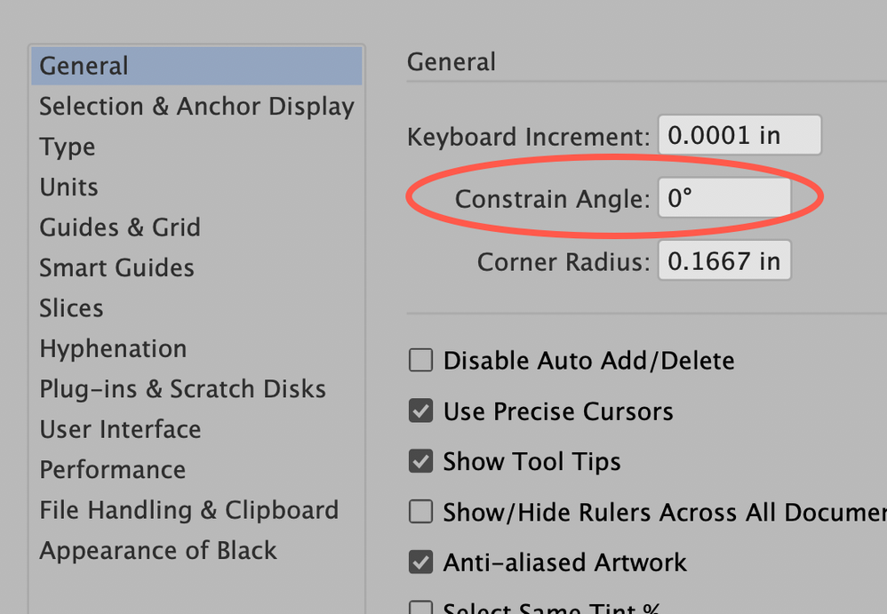

Community Expert , Apr 02, 2020 Apr 02, 2020
Go to Preferences > General and make sure that the Constrain Angle is set to 0°.
I'm not sure about that issue and probably I misunderstand it, but have you already checked the Constrain Angle setting in the Illustrator preferences?

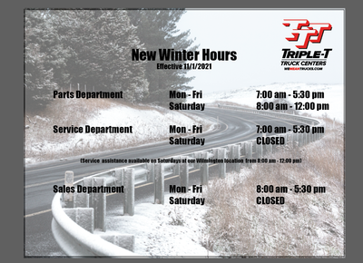

I am having the same problem and my contraint angle is set to 0, so is my scale and my bounding box.
Oct 26, 2021 Oct 26, 2021
Please show a screenshot.

Not sure what we're supposed to be focussing on there but the text isn't slanted:
Mentor ,
Visual trickery, your sloped road and dark left background to bright right, is making your text appear likes it's about to fall off that hillside...

Good point, Met1.
And the two-line type blocks in the middle and right column certainly increases the tilt illusion.
Probably it is also a matter of different perceptions. Some may see the fall and some may not see it at all.
