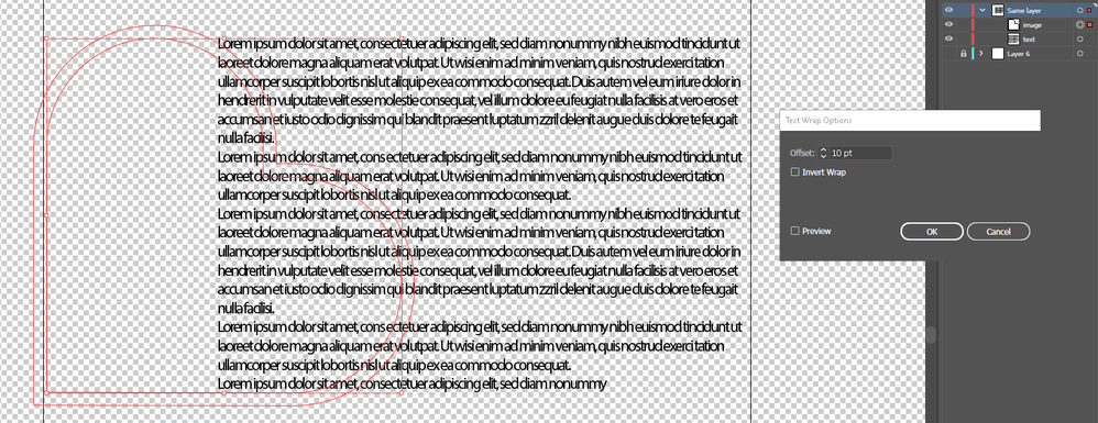

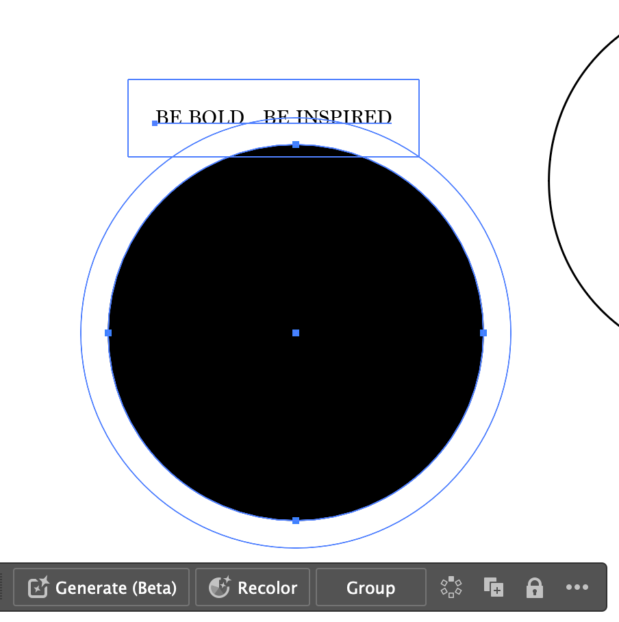

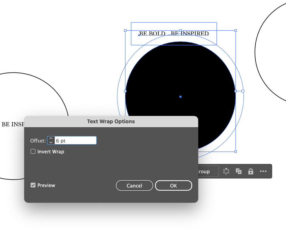

New Here ,
Apr 04, 2024 Apr 04, 2024
Screenshot 2024-04-05 at 11.15.23 AM.pngScreenshot 2024-04-05 at 11.15.02 AM.png
Apr 05, 2024 Apr 05, 2024
Please upload a demo AI file to Dropbox or the like.

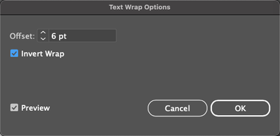

Feb 15, 2024 Feb 15, 2024
Hi I have some similar trouble, doesn't work good.My Illustratos make the wrap but just separate the over and down the object like show in the screenshoot!, More over inside the object appear some lines like if will be text?
Can someone help me please?
Wanderlust and Digital nomad
You have your text wrap set to invert. Select the object, Go to the Object dropdown menu > text wrap > text wrap options and uncheck invert.
Melissa Piccone | Adobe Trainer | Online Courses Author | Fine Artist
New Here ,
YEEESSS, I got it late. Thank you so much!
