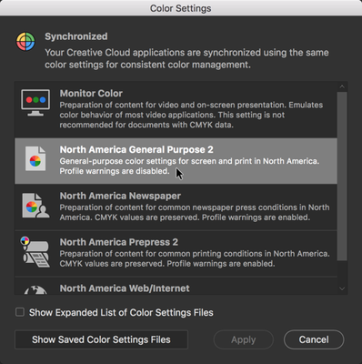

Why don't you use CMYK in the photos? In this way, you maintain the consistency of color according to the parameters of your print provider.
First set your color settings in Adobe Bridge:
Convert your images to this color space and apply the shadow in Illustrator:

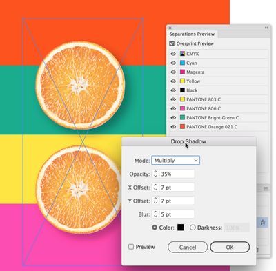

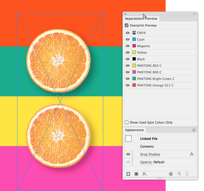

For this sample I use 100% Black with Multiply

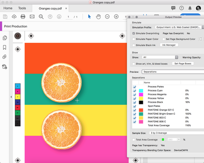

Here's the file in Acrobat

But just so you know, we see the exact same thing when inspecting in Acrobat as what you're showing in your example (Note that the images are converted to CMYK during the PDF creation). It's only when we output to our local printer that we see the issue. So we just weren't sure if it was an issue with our Fiery RIP, and if there was any potential of the final printer experiencing the same thing.
