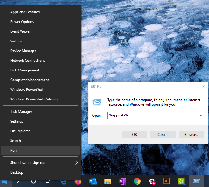

Hi there,
Let me help. AppData folder is hidden by default in Windows.
You can go here like this:
Right Click on Start > Run > Type "%appdata%" & then click on OK.
You will be able to see Roaming folder directly.
I have also attached a screenshot as well for your reference:
Hope it helps.
Ashutosh
