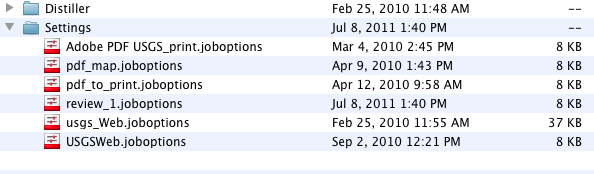

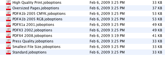

When I run the script (either from the ESTK or within AI) it gives me a combined list from two different sources. The first is the list of the suite installed joboptions which are located in OS/HD/Library/Application Support/Adobe/Adobe PDF/Settings like this
The other joboptions shown are the user defined ones from <your account>/Library/Applicaton Support/Adobe/Adobe PDF/Settings like this
and here's the list from running the script from AI
I will have to agree with MuppetMark that it is something with your install that is off.

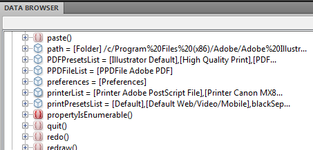

I see it in mine
Copy link to clipboard
Copied
CarlosCanto wrote:
I see it in mine
Thanks, Carlos. I gather you are running on Windows? It seems that this may be a Mac-only problem. I've filed a bug report with Adobe...
