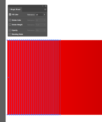

I don't see why it would operate differently.
Edit: It does appear different, strangely.
If I create a 255/0/0 to 0/0/0 gradient in Photoshop and select with a tolerance of 10, I get a selection from 255 to 245.
If I create a 255/0/0 to 0/0/0 object blend in Illustrator and select with a tolerance of 10, I get a selection from 255 to 230:

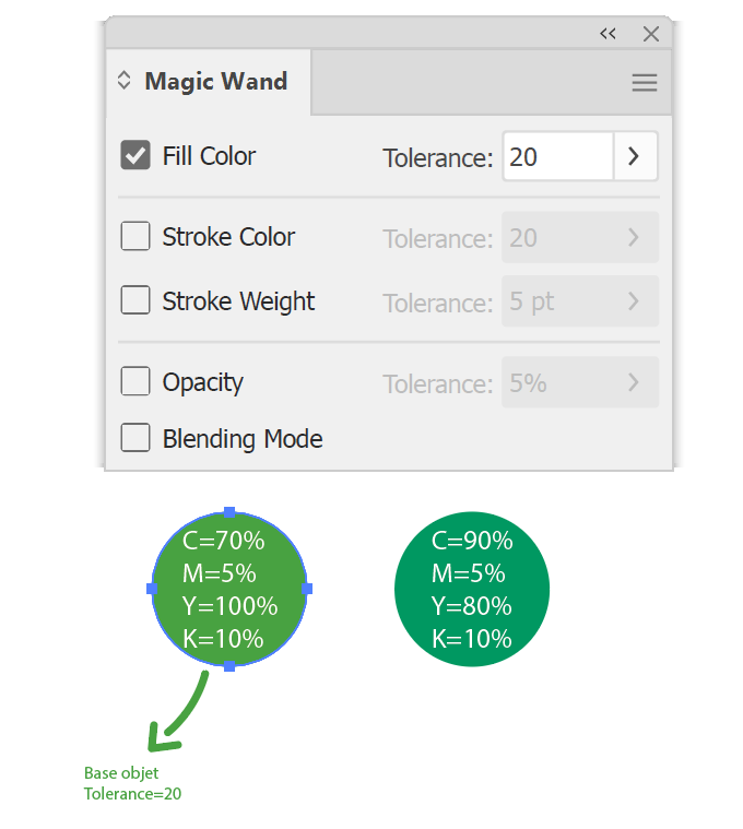

Community Beginner ,
Aug 11, 2024 Aug 11, 2024
"Hello Anshul_Saini,I have a base object with the following color values: C=70%, M=5%, Y=100%, K=10%. I also have another object with color values: C=90%, M=5%, Y=80%, K=10%. I set the tolerance to 20, and according to the logic you provided, the object should have been selected, but it was not. Could you please help me understand why this is happening?"
Does it work if you change the tolerance level to 21 instead of 20?
Aug 20, 2024 Aug 20, 2024
No it does not work if I change the tolerance level to 21 instead of 20.
Aug 12, 2024 Aug 12, 2024
20 in RGB does not necessarily transfer to 20 in CMYK.
