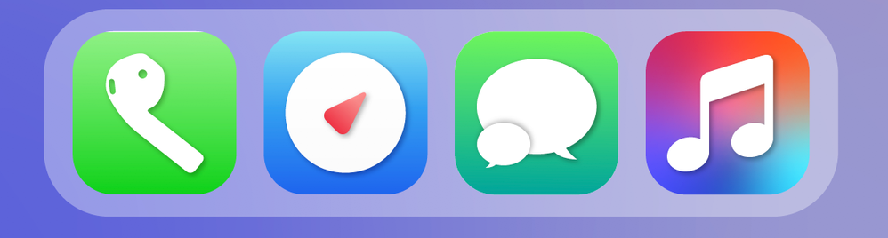

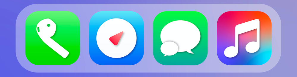

Community Beginner ,
Jul 31, 2020 Jul 31, 2020
Screenshot 2020-07-31 at 4.30.43 PM.pngScreenshot 2020-07-31 at 4.31.02 PM.png
1st is a screenshot of the PDF, 2nd is the screenshot of the JPG.

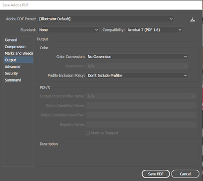

Depending on how you export exactly (Save As, or Export for Screens etc.) you should see a PDF settings window like this, with colour settings and other information about what exactly you're exporting.
Screenshot 2020-07-31 at 5.09.11 PM.pngThank you for the explaination, I used "save as" as my method. So what should I do right now?
What happens when you include profiles?
Also: Apple Preview can show you if there's something in the file (but I wouldn't even rely on that). It won't be able to show you correct colors or anything like that.
For Acrobat: you need to check its color management settings.
Also: how are your color management settings in Illustrator?
Yes, the problem was solved when I included profiles. Thank you so much!
