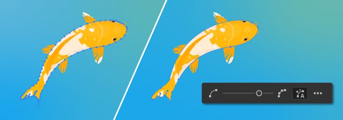

With the Simplify option, we can remove unnecessary anchor points and generate a simplified optimal path for our complex artwork, without making any significant changes to the path shape.
Simplify option would solve problems related to complex path editing.
Key benefits -
  • Easy and accurate path editing
  • Reduced vector file size
  • Faster file display and print

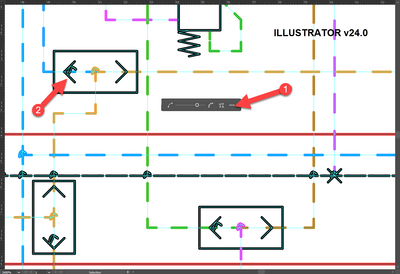

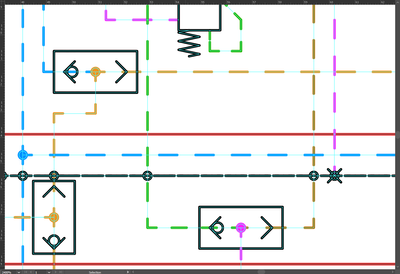

When I select Object > Path > Simplify, a new dialog (1) opens (images below) and for example all circles are reshaped (2). Even though I remove the Auto-simplify selection and open the More options dialog circles are not returned to the original shape (3). And the sliders does not have any affect to the reshaped shapes.

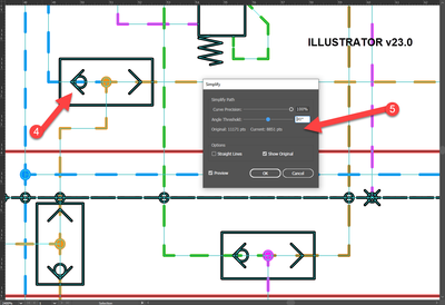

In the last image is an example how this looked like in the Illustrator v23.0. When the Simplify dialog (5) was opened the shape did persist as it was (4), or at least with sliders it can be set to be as it was and still the amount of points was reduced.

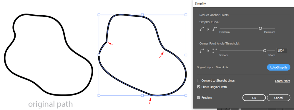

I am also having problems with the new Simplify Path: Oversimplification and introduction of new edges significantly changes the original shape. Adjusting the sliders for smoothness or angle threshold doesn't fix this. Auto Simplify Path result introduces new edges in shapeAuto Simplify Path result introduces new edges in shape
I still have AI CS6 installed and even that gives better results without newly introduced edges.
