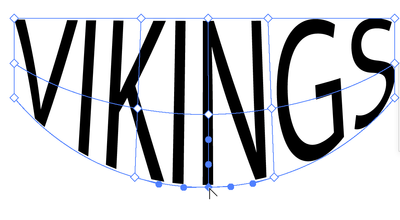

Here I am working with live type.
I used Object>Envelope Distort>Make with Warp.
I used Arc Lower, then made a few adjustments.
Just took moments.
K

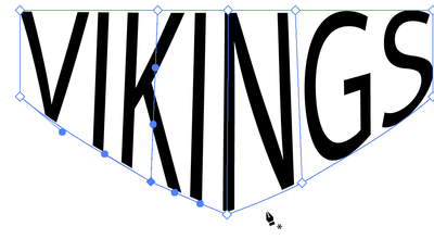

After you use Arc Rounded, add a new mesh line using the Mesh tool. If you don't see the Mesh tool, click the 3 dots at the bottom of the Tools panel and choose Advanced.
With the Mesh selected, select the Mesh tool and click in the center to add a new mesh line.
With the Anchor Point tool, click the bottom center anchor point.
With Pen tool, you can hold down Alt (Windows) or Option (Mac) and individually manipulate the handles that stick out on the left and right.
You can also repolition the anchor, but it is a delilcate situation so be careful as you are manipulating handles and anchor points.

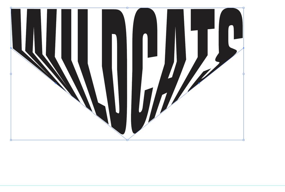

I'm real close. But when I follow what you did, I'm getting this.Wildcats.jpg
Dec 05, 2024 Dec 05, 2024
You have to do it like this:
Use Make gradient mesh first with the selected anchors, then make the envelope
https://youtu.be/aqQATfZE9g0
