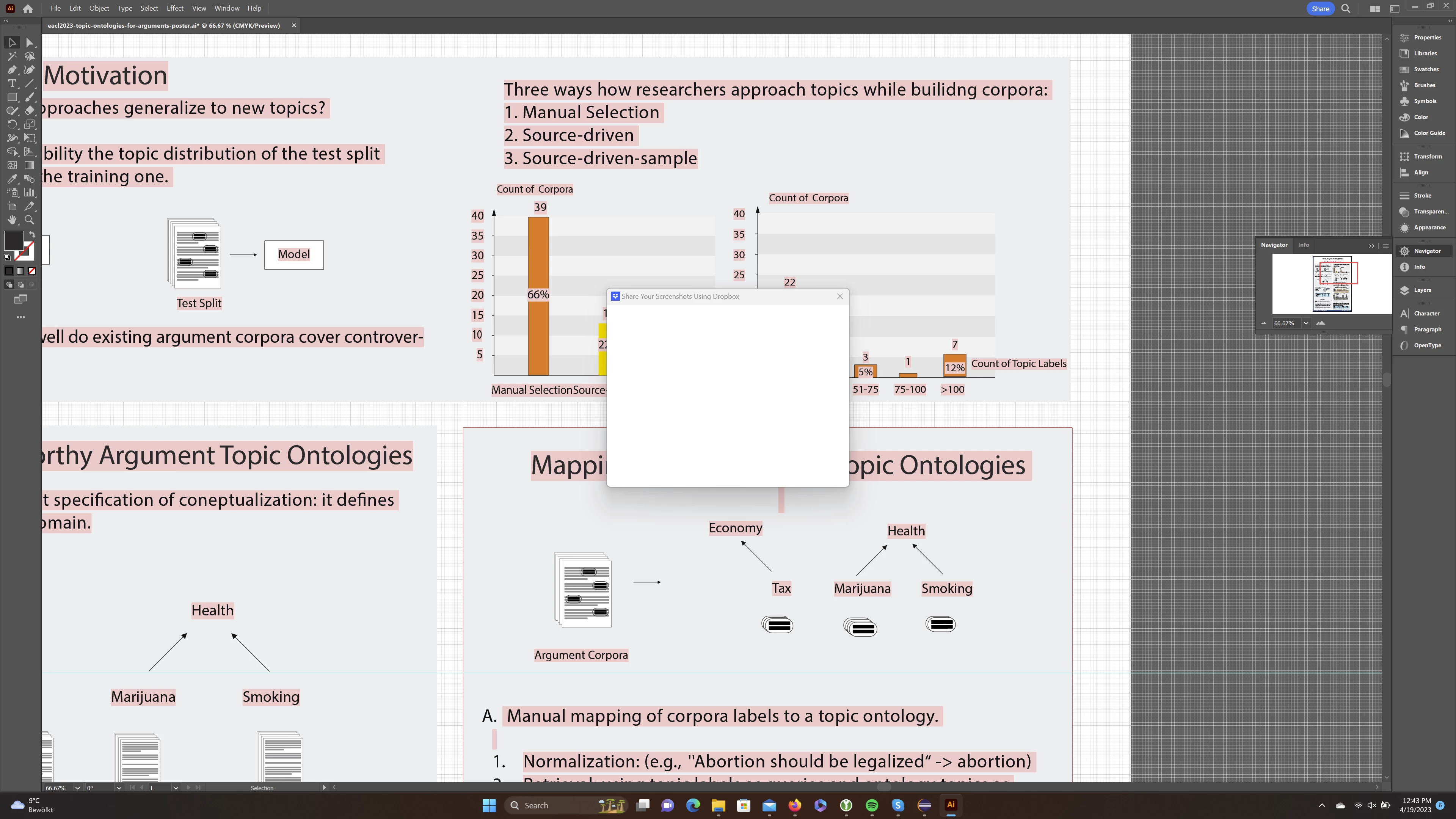

Why are all my text boxes are highlighted in red
New Here ,
Apr 19, 2023 Apr 19, 2023
Copy link to clipboard
Copied
Why are my text boxes all red
ed?
Views
4.1K
Community Expert , Apr 19, 2023 Apr 19, 2023
This usually indicates that illustrator cannot find the font you are using.
Sometimes, the font does not load properly and you need to restart, sometimes it gets confused or a font is not activated (if you have a font management software or it is a cloud font).
From the Type menu, there is:
  • Resolve missing fonts...
  • Find/Replace fonts...
they can help locate the source of your issue.
