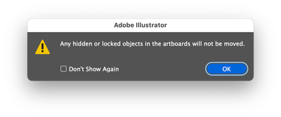

I cannot replicate that, when I duplicate an artboard with a hidden or locked layer, I get this:
Where did you set it to copy hidden layers?

Thanks Richard (did not look there).
But when I turn that on, the message about locked/hidden layers does not come up during duplicating the artboard, but the layers stay locked and hidden in the duplicate.
