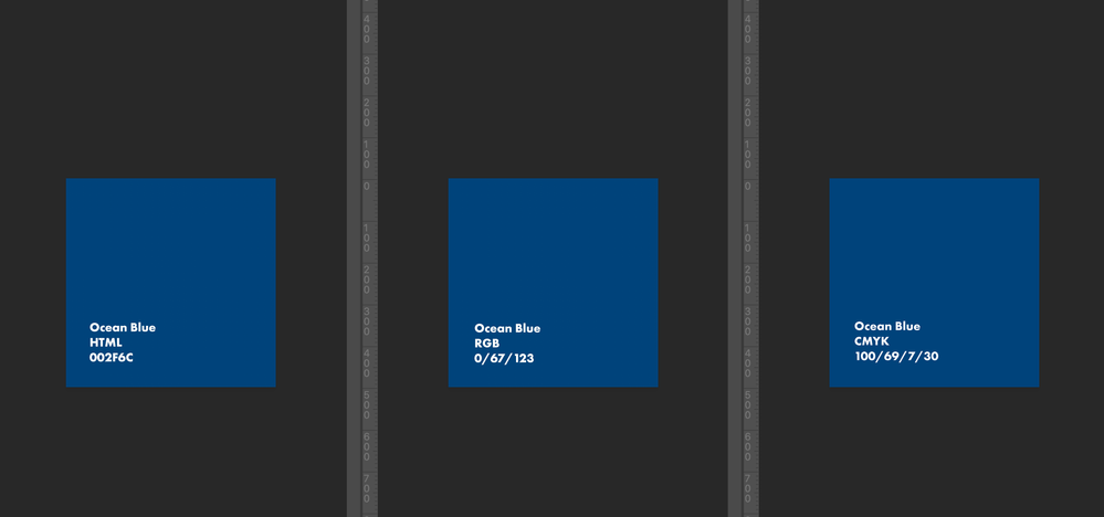

    I think some of these responses may have been missing the point. We can get all scientific with light and substrate and the printing process but at the end of the day, client and people decide and comment on what they see, they don't care why it looks different.
    I have many years of experience on this and I am still super annoyed by Pantone. Recently completed a new logo for a client and provided guidelines including brand colors. I dutifully used my Pantone color bridge to specify the CMYK, RGB and HTML values to use for each Pantone color. All good I thought.
    The web designer for the client reaches out to me today because he's using the HTML values I provided and they look nothing like the Pantone or the CMYK look on the screen. (I understand PMS and CMYK are printing formulas). I go into photoshop, create a CMYK mix, an RGB Mix and an HTML mix based on the Pantone book, and yeah he's right, they look darker and more Navy. I then use the RGB and HTML values that Photoshop (and Illustrator) provide in the COlor Picker and, voilá, colors match on the screen.
    Why does Pantone do this? The point of an RGB or HTML equivalency is to match 'visually' what the CMYK/PMS printed piece will look like. Now I have to go back to the client with my tail between my legs and say that the colors are wrong and that the guidelines I had custom-printed now have the wrong values.  It's just maddenning.
    See my examples and you will quickly figure out which one uses the PMS-given values. and which is what Photoshop gives you.
