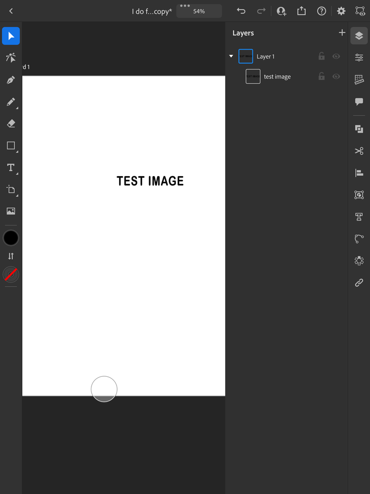

Please show a screen shot of your image in Illustrator for iPad and include your layers (as below). What are your exact steps to Export (not Save) to PNG?
If you don't have transparency in your document, saving it as a PNG will not create transparency. It has to be there. I'm guessing one or more of your layers does not have transparency.

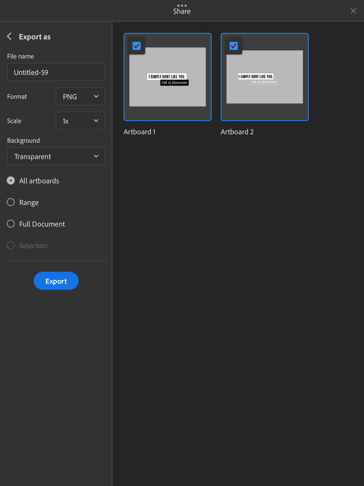

Hi, steps to Export are: Export > Publish and Export >  Export as > Format: PNG > Background: Transparent

Hi @Peter25711337ject
Your Layers panel says "Test Image". It appears to be an image with black text and a white background. There is no transparency and exporting to png cannot create something that is not there.
  • Delete the image that fills your artboard and type some text with the Type tool.
    or
  • Resize the image smaller (Selection tool) so you have transparency.
Export to PNG again.

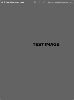

I don't think there's a layer with white background - you cannot see it in the layer thumbnail @jane-e
I cannot reproduce the issue @Peter25711337ject
I created an identical document. The PNG exported has no background:
How are you viewing your PNG? You need to have something underneath to "see" the transparency.

Hi both, this is how I see the picture when exporting it. I am doing something wrong because I managed to get the transparent background for a few times but I cannot figure out the issue.
Explorer ,
Dec 14, 2022 Dec 14, 2022
This image looks as if you have a fill in the text box. Be sure to choose the circle with a red line through it for both fill and stroke.
