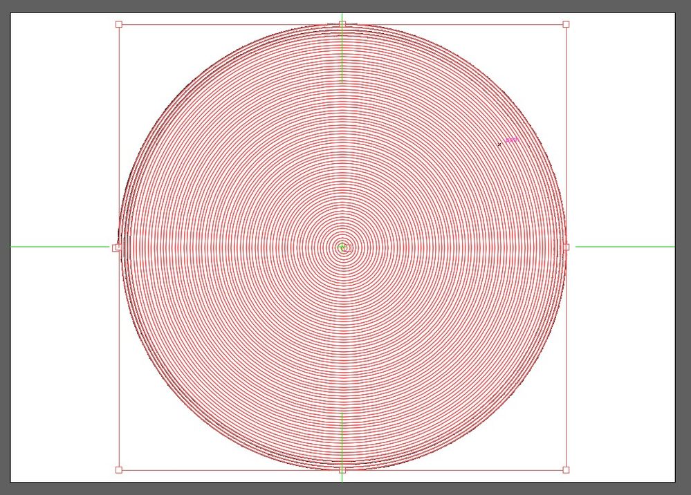

I have 50,000 words that I need to put on a really long spiral, the text will start at the outtermost line and conclude towards the end of the spiral.
Legibility is not an issue here.

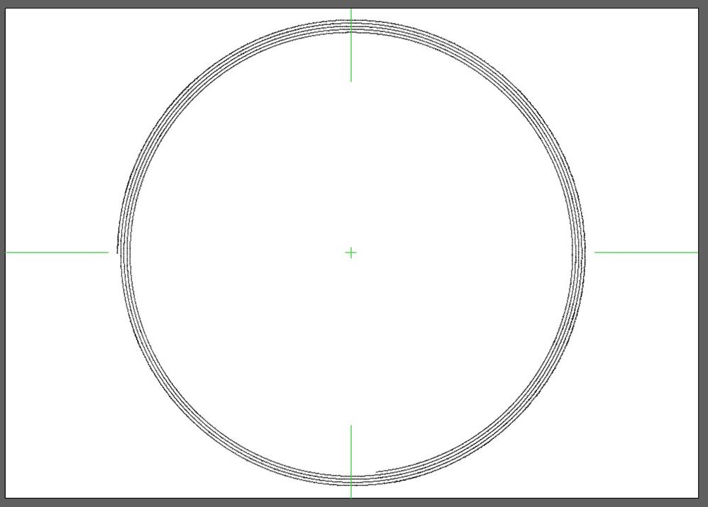

I have attached two artworks on how I approached it, I created a spiral of 75 lines and then made that a typable object, but the moment I bring in all of the text, Illustrator crashes.
Would anyone please have some guidance or advice how I could solve this?
Thank you
Screenshot of the spiral as a type objectScreenshot of the spiral as a type objectAnnotation 2020-03-13 131906.jpg
