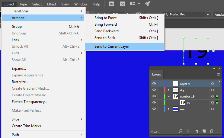

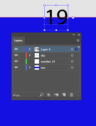

I am having a lot of trouble moving an object onto a layer. See in the below picture that the green 19 is stuck behind the gold layer on top of it.
Do you know what I have to do to move it on top of it?
Thanks in advance.

Engaged ,
Jan 28, 2017 Jan 28, 2017
Move an object to a different layer
  1. Window > Layers (F7),
  2. Create a New Layer
  3. Select the object. (number 19)
  4. Do one of the following:
  5. Click the name of the desired layer in the Layers panel. Then choose Object > Arrange > Send To Current Layer.
    Drag the selected-art indicator , located at the right of the layer in the Layers panel, to the layer you want.

New Here ,
Thank you all for your comments. Thanks to your help, I have now resolved this issue.
