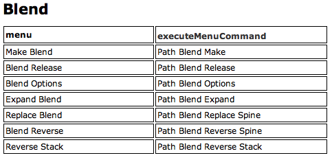

Thanks. Yeah I had seen there are some, but I am exuberantly using CS5, so I miss out on a few things, both in usage and testing. 😉
Do those work without dialogs and user interaction ?

Sorry. I haven't CS6+ here at home. Perhaps I can try this at work in the next days.
But IMHO:
app.executeMenuCommand('Path Blend Make');
should do without a dialog.
app.executeMenuCommand('Path Blend Options');
I think this command will show the blend options dialog (like in the UI)
Greetings
Aug 02, 2015 Aug 02, 2015
yeah, the Blend Commands work as if the user is clicking the menus, except we don't get a chance to change the dialog options.
