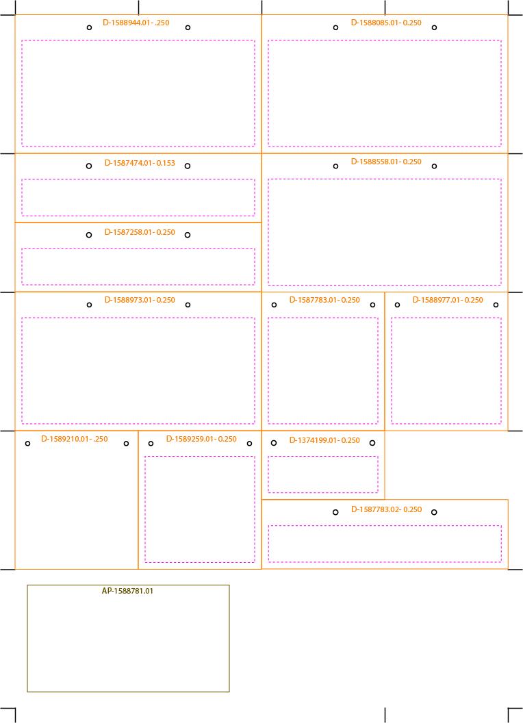

We use a script to place our dies on an art board before sending them to get made.  We managed to narrow the sizes down 4 different ones and the script for making them will automatically scale depending on the size of the artwork.  This reduces waste of the material, and since it is automatic it makes work faster for the other artists.  I'll be posting snippets shortly.
Participant ,
Feb 17, 2015 Feb 17, 2015
The below image shows the 4 different die sizes, the artwork fits inside the dotted box so make sure that we have room around the die and the drill holes are assigned as well.
The name of each die is listed above it, and the size is listed below it.
The script is set to take each die and place it on the template until it is full, then it will save it and move it to the folder where it will be grabbed and preped for printing.
Everything below the **** is the script.

                alert("The current template has been saved to the Printed Templates folder.  This page is to be printed and sent to editing.")
Hope this helps someone get one created because if they can make one that doesn't depend on the premade dies that would help me out quite a bit because some of the dies that we make are an odd size so we have to place them manually.
Participant ,
This is the image of the finished product, all the ones that are auto placed are colored with an orange box, the ones that must be placed manually are brown.  The colors help people understand which ones need to be moved a lot easier.  I've removed the art files from the boxes as some of them are copyrighted so you can only see the boxes for this file.
