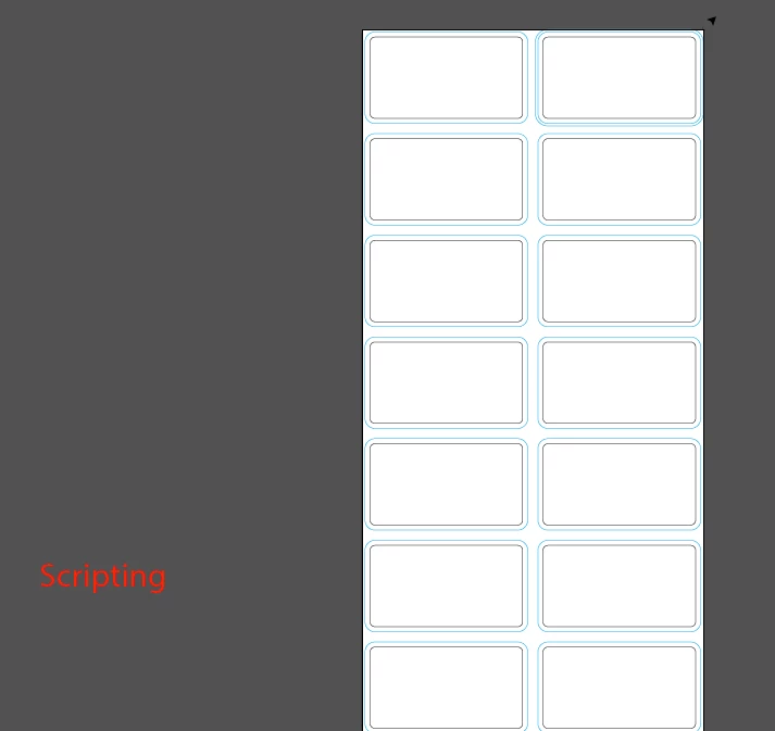

I have the above file and when I run my script.  The text appears all the way to the left.  The rulers show that 0, 0 is supposed to be at the beginning of the document.
This is my code:
var text = doc.textFrames.add();
text.position = [0,0];
text.textRange.size = 60;
text.textRange.characterAttributes.fillColor = col;
text.contents = "Scripting";
I have also tried
text.top = 0;
text.left = 0;
Neither of these work, the script type is positioned in the same place.  Any ideas what I'm doing wrong?

Have you checked the "Artboard" x,y position? I had an instance where everything looked good in the file, but ".position = [0,0];"m did not work. Opening "Edit Artboard" revealed the Artboard was not aligned to the top, left corner. Fixing that fixed the script.

I just ran into this situation today and was confused why a selection did not move to "0,0" as expected. Then I found the Artboard was offset. Thought it might apply here.

Illustrator has both artboard rulers and global rulers. If one of them was offset you might have this issue

That sometimes may help. But does not help, if the zero point has changed.
See here:
Change origin of artboard rulers
and
Move RulerOrigin to specific location
Have fun
