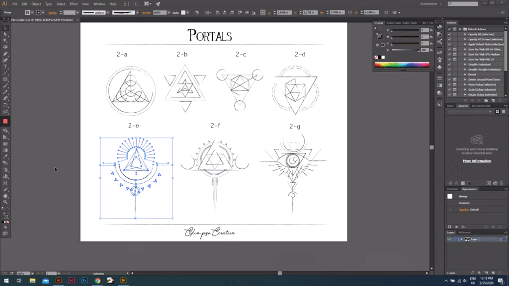

This is my second time posting about the same issue because I still haven't figured how to resolved it.
I'm trying to convert .ai vectors in .png on Adobe Illustrator CC 2015. The vector isn't staying intact through the conversion. How should I convert my .ai vector into a .png without being altered.
I've attached an example of my problem as well as a short video of my screen to show the steps I'm taking for converting ai to png.
Hope someone can spot where I'm missing something.

Mar 29, 2020 Mar 29, 2020
Your screenshot isn't downloading and the video doesn't work. Please include images directly in the post by using the forum's web interface.
That said: your vector cannot "stay intact" when exporting a PNG. PNG is a raster image, there won't be any vector paths in it.

Entdecker ,
Mar 30, 2020 Mar 30, 2020
Sorry for the trouble, I'm not so tech savvy. I've included the image on the forum's web interface this time.
Do you scale it when exporting?
Does it get better when you don't export it transparent?
Does it get better when you open the AI file in Photoshop and export from there?
What kind of stroke is that? Ans which lineweight?

Mar 31, 2020 Mar 31, 2020
Hey,
Thanks for your reply.
I don't believe I scaled the image when I exported it. On the "save for web" window in the section "image size", the width and height of the original and new size are the same. I also used the "retain original image proportions"option.
The end product that I need to provide to my client requires a transparent background.
It does get better when I open my AI in Photoshop and do the conversion there. Although once it is in PNG, if I make it smaller, it becomes gray and very thin.
The brush I used for my illustration is "Charcoal - Thin" and the lineweight is 0.25 pt..

Apr 04, 2020 Apr 04, 2020
Hi.
I finally resolve the problem thanks to Monika_Gause who answered it in another post.
Looking back at my initial post, I see that I wasn't specific enough about my problem.
Which was Illustrator exporting dashed lines with solids line behind them. I wanted to share my findings with the community with a short video showing the steps I’ve take to fix the problem just in case someone else searches for this in the future.
