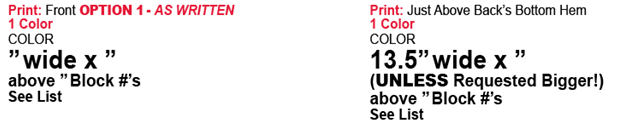

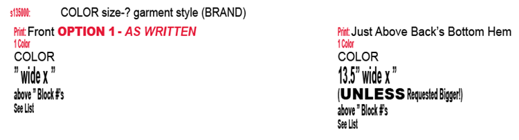

Just started happening today at my office - coworkers are not having the same issues with their versions of the program while opening the same files. Every file I open has squished text and I get this message when I try to edit it.
I know this isn't true because I just created some of these files before the weekend. As far as I know there weren't any automatic updates. I've tried updating my program manually through the desktop app and I've restarted both my computer and the program a couple times but the issue persists. This is an example of how the text should appear vs how it's opening on my computer.

Hi Bill, I'm using CC 2017. Update: this issues seems to be specific to any instance of Arial Bold and no other version of Arial or another of font (so far as I can tell). I thought maybe I could delete then re-install the font but it's a protected system font. Any thoughts?
