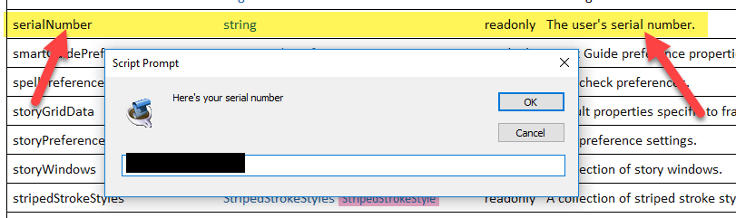

Попробуйте запустить этот скрипт:
prompt("Here's your serial number", app.serialNumber);
Можно сразу и скопировать.

Hi Kasyan,
I don't think that app.serialNumber will give you the complete number.
( Cannot test this right now because all my InDesign versions installed are cloud based and my CS5.5 is installed with a machine I currently have no access to. )
Uwe
Valorous Hero ,
Nov 07, 2018 Nov 07, 2018
Hi Uwe,
You are right!
I remember, but not sure, it skipped a couple of last digits in CS3.
But right now, in CC2018, it returned only 20 digits instead of, i guess, 24.
Anyway, I don't have any more ideas.
