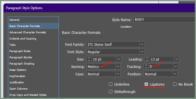

hi everyone see in this pic i have set kerning 80 (kerning in thousand of an em) , these are 100 pages of book , where many many places words are like this with different names kerning set, how we can change these kerning value to 100 through find and replace or grep or any other way fastly ,  i try alot but fail . any help please. thanks in advance.

If you set an override or global value for kerning, it will be applied regardless of what the font data specifies for each character. More importantly, it will override the many kerning pairs defined in most fonts, including, most likely, one for the two letters above.
Start by resetting this style, or all styles, to "Metrics" kerning (the default) and removing all overrides you may have applied. That should eliminate all these gaps, which your global setting has created. Also check the other two settings noted, for each affected style, as they can have similar effects:

i want to increase kerning gap between characters , how we can do it in paragraph style . didn't solve my issue. i dont wana eliminate all these gaps ...
