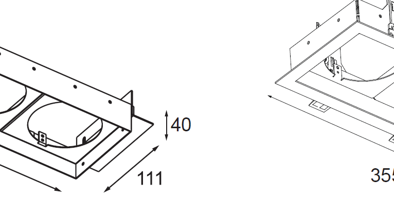

when exporting an Indesign file to PDF the line thickness of the Illustrator drawings used is not correctly shown.
Zoomed out (and printed) it seems like the first 3 line drawings have a lighter line thickness:
Zoomed in it's clearly visible that the line thickness of the 3 top drawings is denser.
I have no idea what causes this.

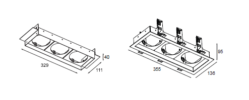

This is what it looks like in Indesign: The right hand drawing is clearly lighter due to a smaller line thickness (0.1pt versus 0.25pt)
When exported to pdf the right hand drawing looks slightly thicker:

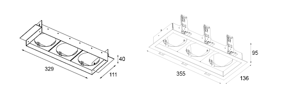

When zoomed in the right hand drawing shows the difference in line thickness much clearer:
