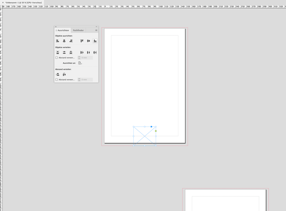

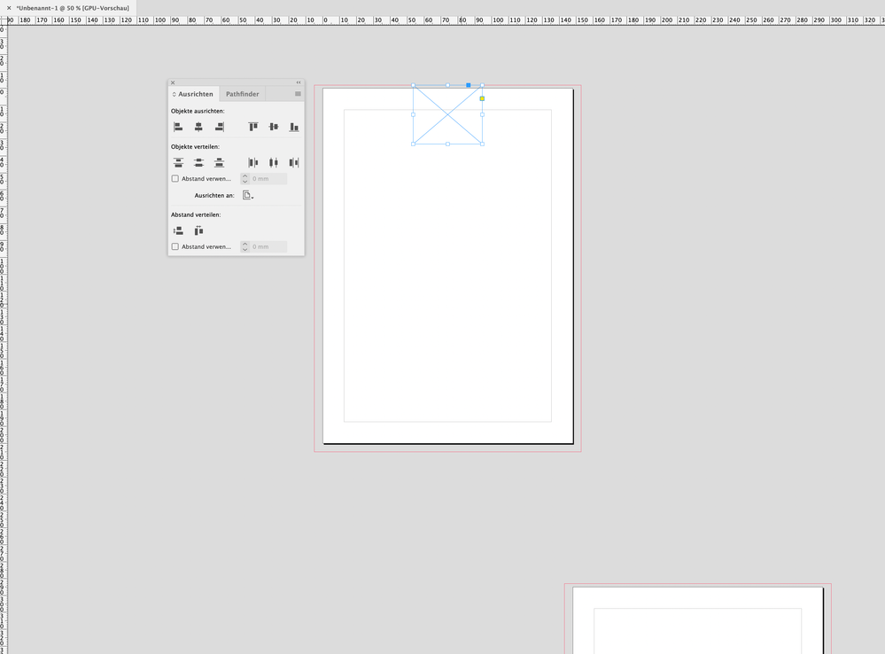

Top Align and Bottom Align will work with different bleed settings. Align Top:
Align Bottom:
