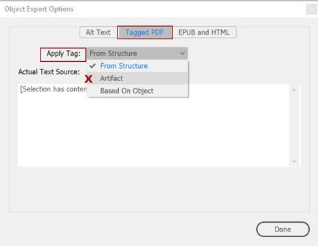

pbaliski13 wrote: "when I run accessibility in Acrobat the images are not tagged."
Just confirming: when you view the Tags panel, the graphics are not tagged with the <Figure> tag? If that's the case, then they are being artifacted.
Here are some things that can cause this to happen:
  • Anything placed on a Master Page is automatically artifacted.
  • A graphic anchored into a paragraph of text will be artifacted IF the paragraph of text itself is artifacted.
  • The graphic itself or its frame was set to be artifacted in Object Export Options.
Do not artifact a graphic or its frame.Do not artifact a graphic or its frame.
  • Sometimes when graphics are copied/pasted into the layout rather than with the File / Place command and an actual AI, EPS, PNG, PDF, TIF, JPG, etc. file is placed into the layout.
  • Graphics are placed on hidden layers or set to not print in the layers panel.
  • The PDF wasn't made correctly. Be sure to use File / Export / PDF (Interactive) and check the options for tagged PDF and tab order.
