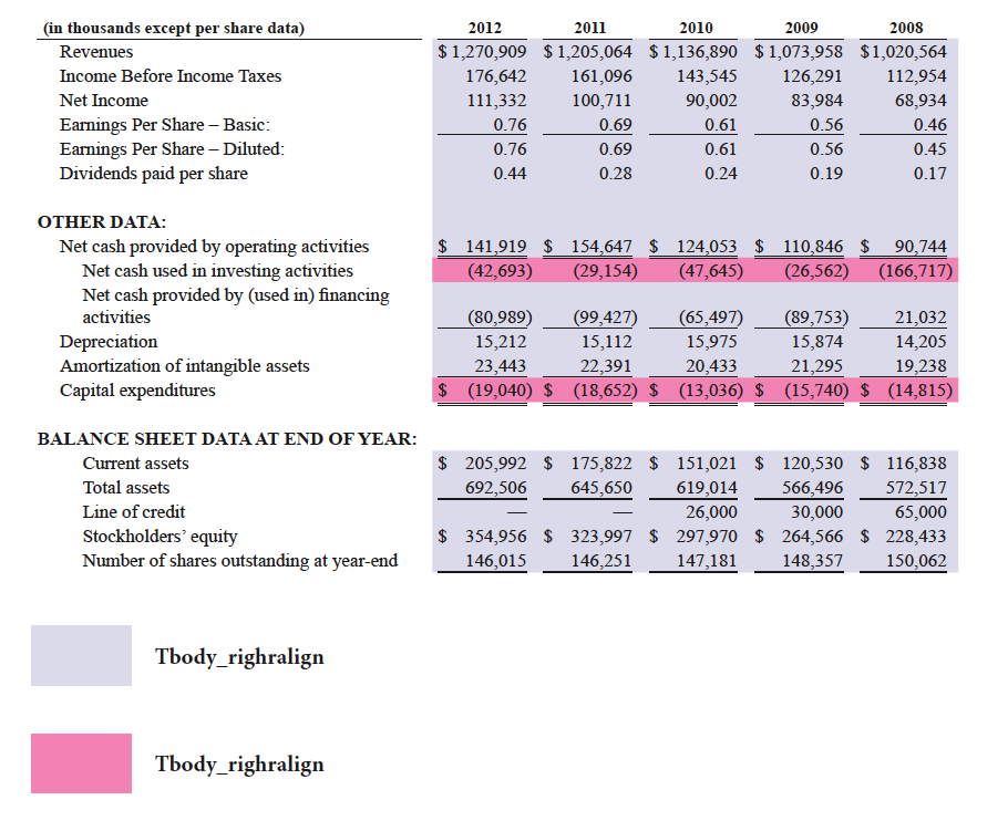

I am working in financial tables. i need script for the below requirement. any one suggest.
For all tables from second column onwards ""Tbody_rightalign" paragraph style. and all parenthesis values should be "Tbody_bracket" style, but these changes to be omitted in first rows because column head having separate style.
Grey should be Tbody_rightalign style.
Pink color should be Tbody_bracket style.
Any one help me pls. i am having 150+ tables.
