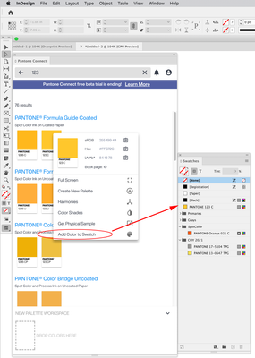

The Pantone .acb files haven’t been updated since CS6. Assuming the CC apps continue to allow the use of .acb presets, there shouldn’t be a problem with saving the current Pantone .acb files and manually copying them into the Presets Swatch Libraries.
For the latest Pantone libraries you can get the Pantone Connect extemsion—there is a free version which lets you search the libraries and add any swatch to the ID Swatches panel:

I think the Pantone Connect extension actually is easier to use than the .acb libraries—the colors are always up-to-date and easy to search.
The only thing to watch out for is the Bridge libraries, which have always been a questionable concept. In theory the Bridge colors are single process CMYK simulations of the Solid Ink colors, but when you add them to the swatches panel they get added as Lab. The Bridge CMYK mix is listed in the extension, but if you think the Pantone build is better than a color managed conversion from the Solid Ink version, you would have to edit the Bridge swatch to CMYK after adding

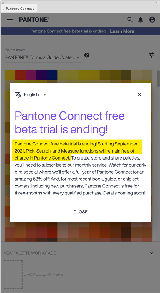

I see this new development as a way for Pantone to start a subscription service (and therefore, generate a dependable stream of income).
Dec 07, 2021 Dec 07, 2021
It look like they are going to continue to offer the search and swatch saving for free.
