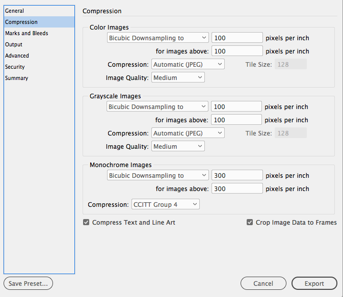

Feb 11, 2020 Feb 11, 2020
Unless you have turned off downsampling and compression in the Export Compression tab, reducing the size of placed images would have no affect on the PDF size. Use the Compression tab in the Export dialog, which will allow you to sample down and compress all of the image links in the document. This would downsample all images with an effective resolution over 100ppi, and apply a Medium JPEG compression to each.

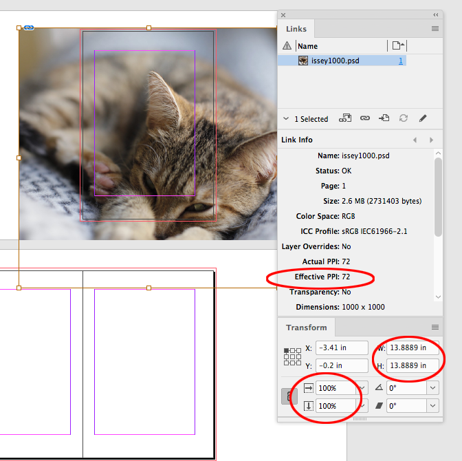

Feb 12, 2020 Feb 12, 2020
Why it's scale 15.9% ?
Because you placed the file, and scaled it down on the page. A 1000px x1000px image at 72ppi has an output dimension of  13.8889 x 13.889 inches (1000/72=13.8889):

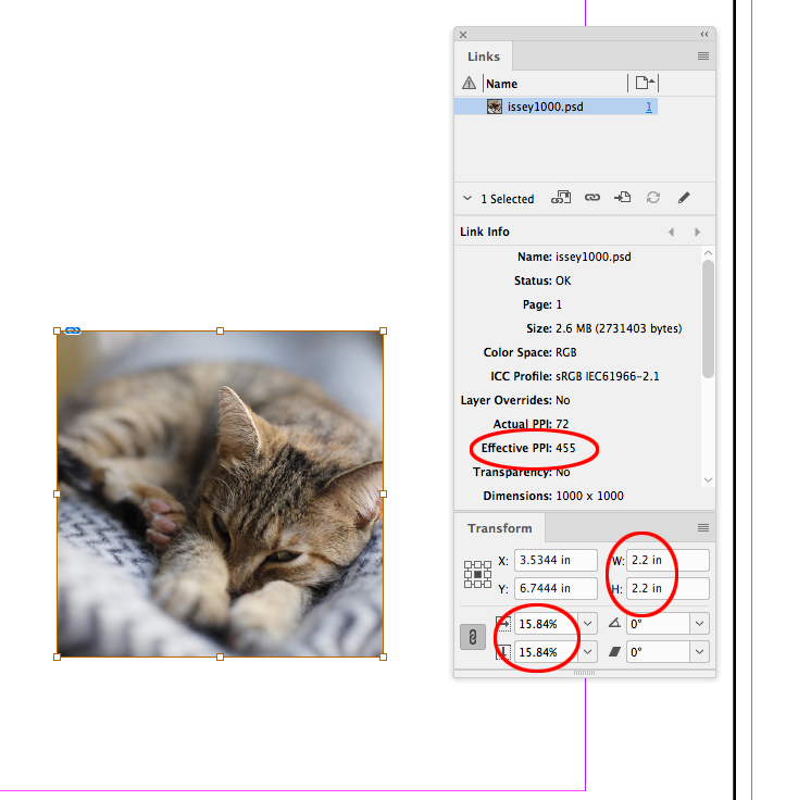

Scaling the image to 15.84% scales both the output dimensions (13.889 down to 2.2") and the output pixel size (1/72" down to 1/455")

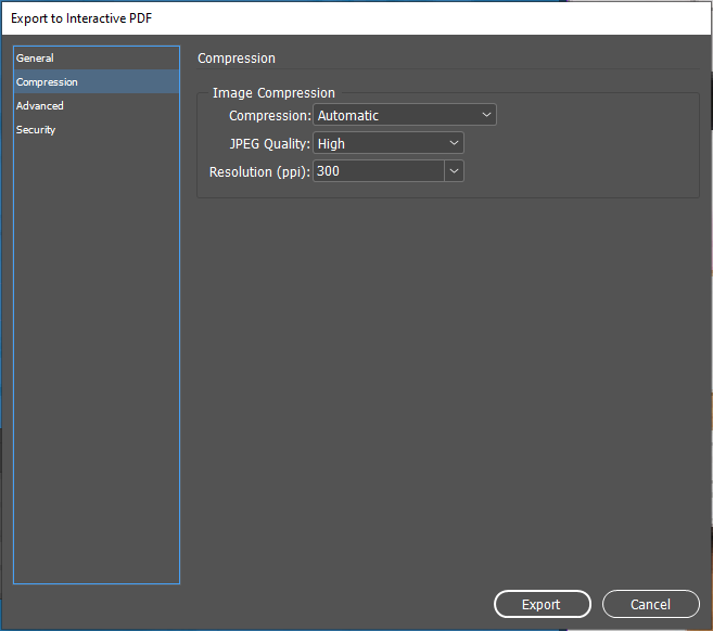

Participant ,
Feb 13, 2020 Feb 13, 2020
Thank you @rob_day for your incredible knowledge and detailed explanations with pictures! I learned so many new things that would help me in the future!
After playing with all the settings, I found a solution that worked for me and my original 10mb file, went to 2.31mb.
The solution was kinda simple. While exporting, in the Compression tab I selected an Automatic compression method instead of default JPEG 2000 (Lossless)... and JPEG Quality from Maximum, I set it to High.
Now you can barely see the difference! And the size became 4 times smaller!
