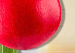

I also had to delete all the shadows that I had created InDesign because they blocked the upload. I now wanted to create the object shadows in Photoshop; but when exported to an epub these shadows have black stripes. I can't find an answer at the moment, and these shadows just make the whole thing so much nicer. Thank you for your help in advance! Judith

Black stripes appearing in your artwork might have to do with anti-aliasing issues, but I would have to see a screenshot what kind of stripes are occuring.
It is a known issue in vector artwork or PDFs and game development when an image is cut into smaller segments and exactly aligned that zooming in and out, or even just displayed at the correct resolution/zoom factor, that rounding errors in the positioning of said image segments cause these minute overlaps and create visible seams or (depending on transparency setting) dark lines between the edges of those segments..
It might also have to do the image export format and working with any version of InDesign released before v2022. If part of the image in InDesign looks sort-of scrambled with vertical lines, or transparency is blacked out, you may be using 8bit colour reduced indexed PNG as a file format to export those shadow images? If your version if InDesign is pre-2022, ensure the colours are not reduced to 8bit.
But it is a bit of a hit–and–miss affair without at least a screenshot to understand what it happening. Or even better: please share a simple test epub with one of the offending shadows.

Stripes in shadow in epubStripes in shadow in epubNoise - Bruit added to shadowNoise - Bruit added to shadowThank you for your quick reply! When I hadn't seen your message yet, I tried something out. I added Bruit/Noise to the shadow in Photoshop and the stripes are gone when I export to epub. The Indesign version is shown as 19.2, it is the monthly Adobe subscription.  Thank you for sharing that all files are best prepared outside of Indesign because Indesign's PNG management when exporting is complicated and creates huge files. So I didn't draw anything in Indesign, no rectangles etc. Deleted 2 empty text frames and converted everything to PNG and everything was good.  Thank you so much!
