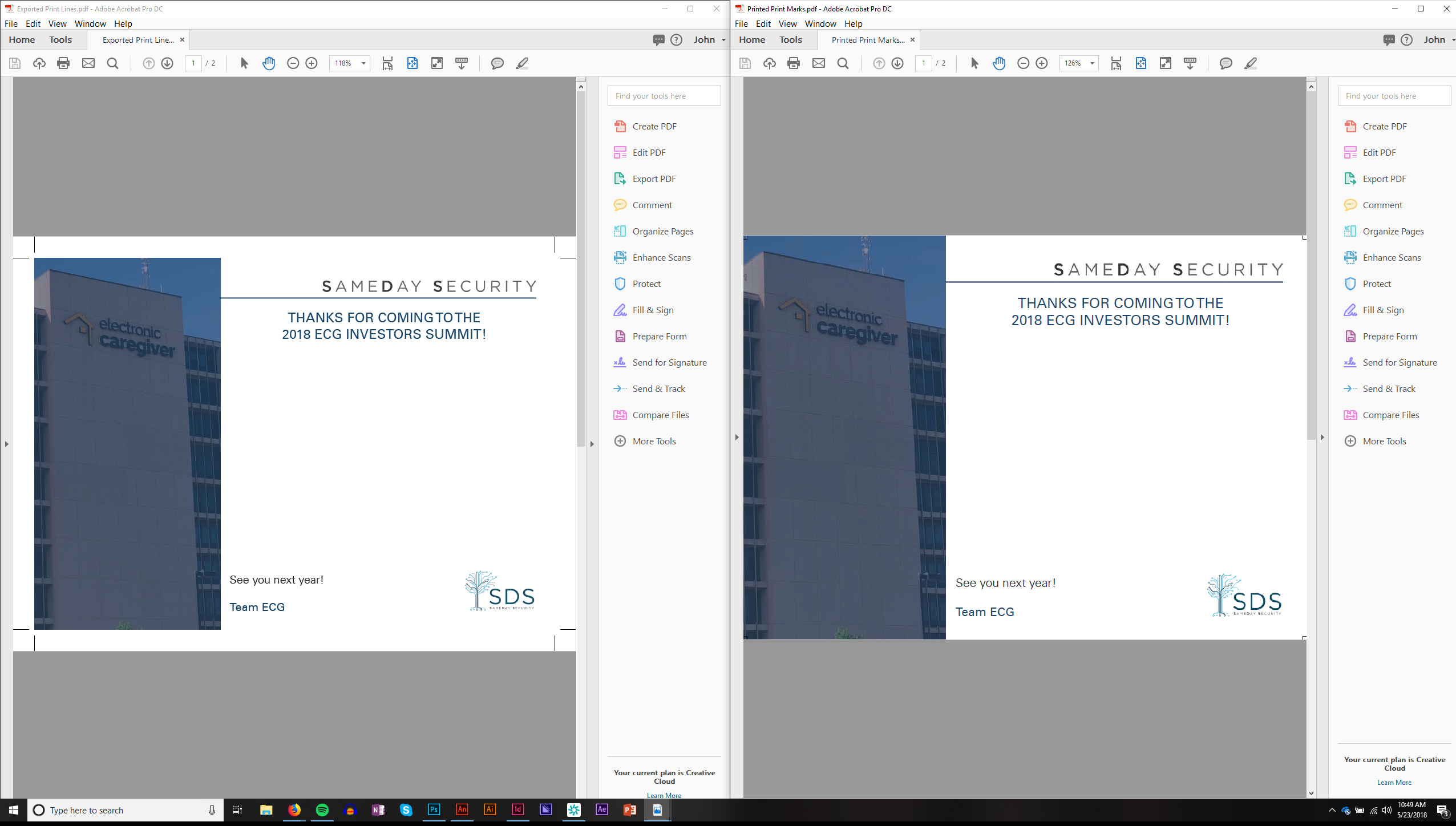

When exporting a PDF from Indesing the bleed lines always end up looking like the crop lines when the file opens in adobe acrobat.
I found a work around by printing to PDF, as these options work properly.
Is it possible that i'm overlooking something? The print dialog is almost identical to the export dialog and I'm doing the same thing for each so it's hard to imagine that I am.

The bleed lines are showing up as crop lines on export. I don't even have crop marks checked. The print shop i'm working with requires them. So I don't know what to tell you.
Okay, I realize I misspoke. I'm still fairly new to this, so I apologize for that.
I need crop lines, not bleed lines. When I export the document with crop lines, the crop lines always turn into bleed lines on export. If I print to PDF it exports properly. I have the exact same setting, nothing is different.
When I export as a PDF it doesn't work the way I would expect it to. When I print to PDF it does work the way I would expect it to.

It looks like you’re not adding the bleed in the export dialog.
Advocate ,
May 23, 2018 May 23, 2018
Bob's exactly right. Click to enable Use Document Bleed Settings. That'll solve the problem.

Yep, I can't believe I didn't notice that. Thanks so much.
Your document has bleed, but looking at your PDF export options, you have your bleeds set to Zero, so none of your bleed is appearing in the PDF. Check the box that says Use Document Bleed Settings to fix this.
