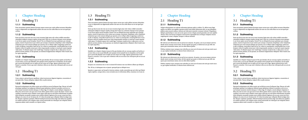

Normally it is done like this:
where the blue headings are level 1 and your T1 is level 2 and T2 is level 3.
But you want to avoid the extra blue level, and I don't really know many ways of doing this.

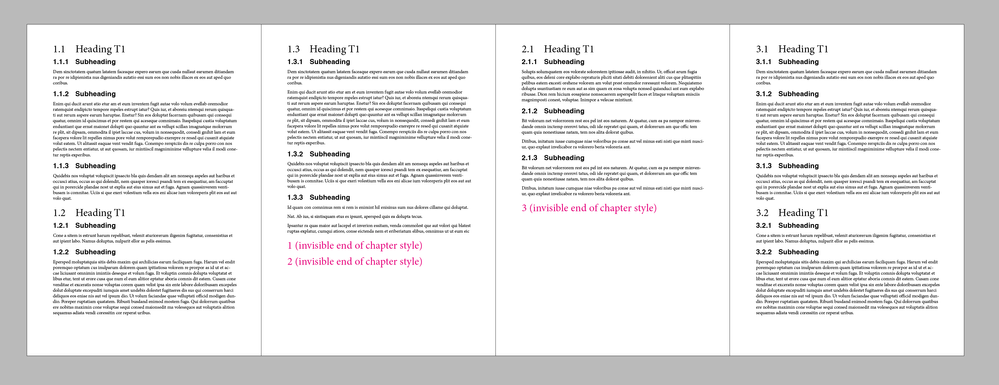

You can visually do it with something like this:
By controlling the auto numbering with an invisible level 1 paragraph style. I called it "End of Chapter" in my demo.indd attached.

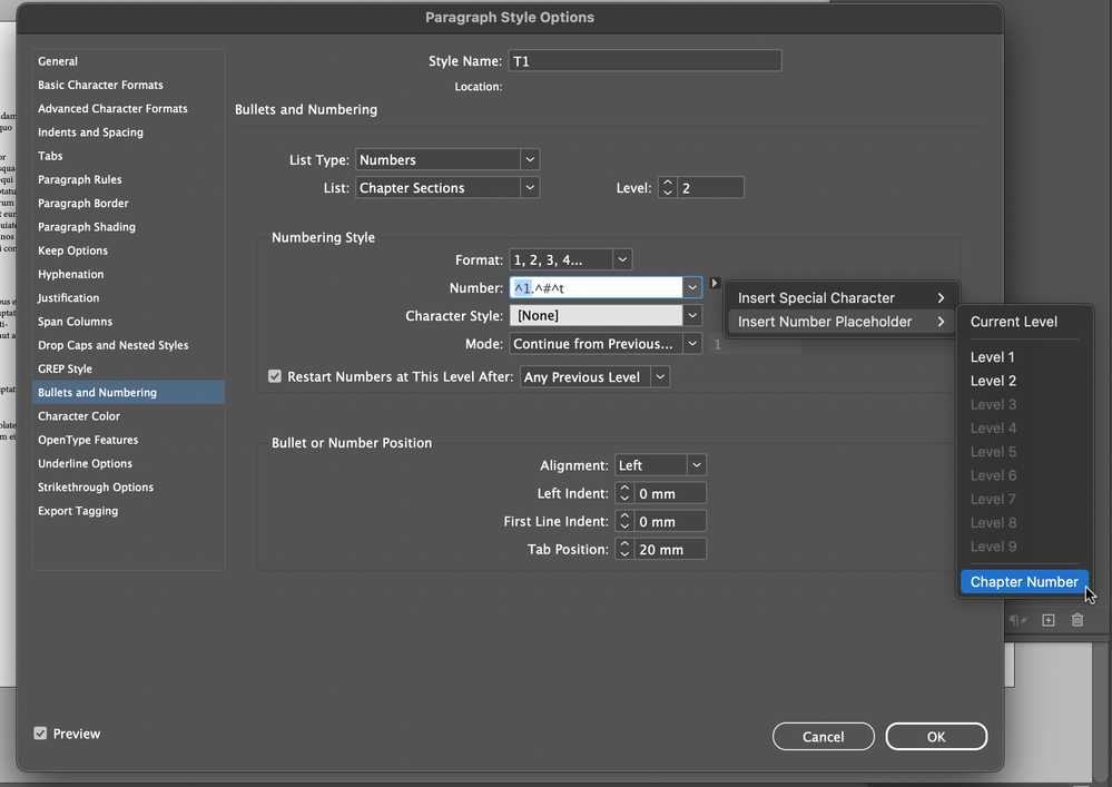

Another way would be to put each top level section into its own document in a Book, and use the "Chapter Number" in your Numbering list.
But that might be more trouble than just creating the extra style.
