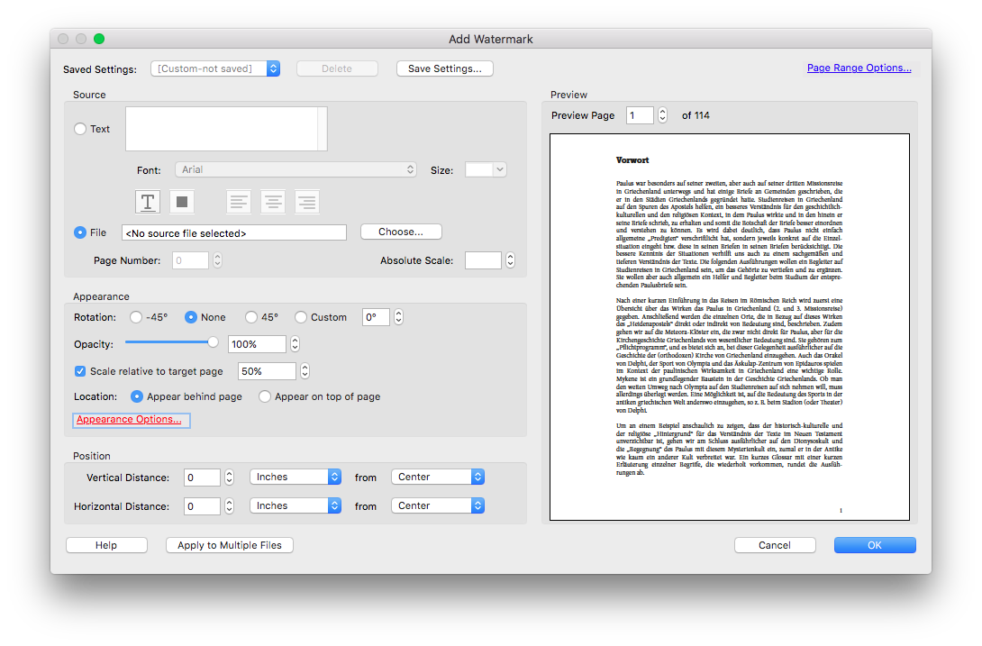

I would create a PDF without that not visible layer and create that layer as extra PDF. In Acrobat Pro you can add a background, use that extra PDF and set this background visible on print, invisible on screen.

Aug 29, 2017 Aug 29, 2017
  1. Create a PDF for the Screen Part
  2. Create a PDF for the Print Only Part
  3. Open the Screen PDF in Acrobat Pro
  4. Tools > Edit PDF
  5. Click on the Add Watermark
  6. Source: Select File > Your PDF for Print only, define the range as you can apply for different pages different watermarks
    You have the best control if the page size of the watermark is the same as the document size, both PDFs.
  7. Location: Behind Page
  8. Click on the Appearance Options …
    Select Show when Printing, deselect Show when displaying on screen.
  9. Save your PDF.
