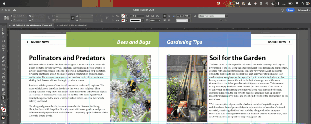

Here's a look at the drag and drop option. You can do this one at a time, or you can select the ones you want to copy and move them all over at one time.
~Barb
