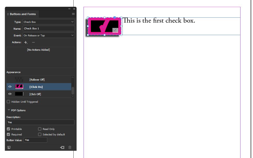

I am formatting a pdf form using InDesign and I want to style the checkboxes using one of the styles from the Sample Buttons And Forms palette. I select the checkbox and then click on the style I want but nothing changes. If I modify the appearance manually, the new appearance will show in the pdf momentarily but then revert to the default appearance as soon as I click on another part of the form. I've tried using ID 2020 and ID 2021. My Acrobat is also up to date. I feel like this is a bug. I can make a workaround but I’d prefer to know why it's not behaving as predicted. Attached is a sample file of a checkbox I modified manually. Thanks in advance for your insights.

So, I am parially to blame. I thought you click to apply the style but you actually drag and drop, so that explains part of my problem. But the issue remains – specifically for check boxes – that they revert to the default checkbox when you export. Other types of buttons seem to work better.

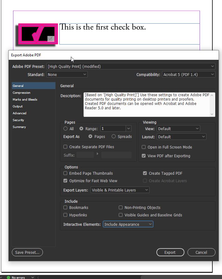

Okay, lol, yea, that didn't make sense so I had to test it. Seems to work fine but I may be missing what you need to do since I've never tried it before. I created an ugly check box and in the PDF dialogue, checked under Interactive Elements to "include appearance" and the PDF had my same ugly check box that worked in a form edit...

However, so does your checkbox, @L Gryfe. When I enable it, it is a full to the edge of the frame black square. It does not change when I click outside of it.
~Barb

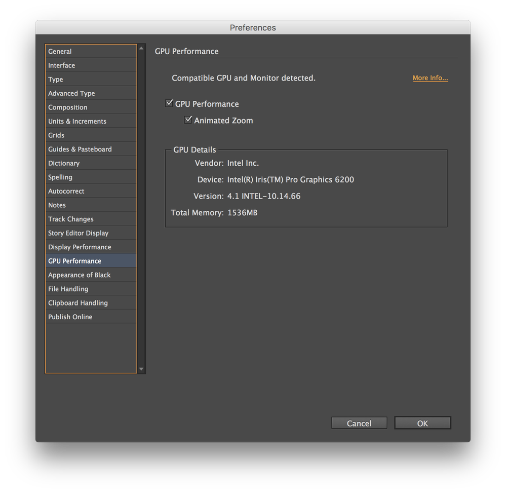

@L Gryfe I've read a lot of people had problems with their GPU performance settings in Big Sur. Have you tried turning it off or on?gpu_preferences.png
Contributor ,
Jun 10, 2021 Jun 10, 2021
Not for ID or Acrobat, but I have for Illustrator. They just announced they're releasing the updates for the M1 chips soon. I can't wait! I'm crossing my fingers that this will make a lot of my problems go away.
